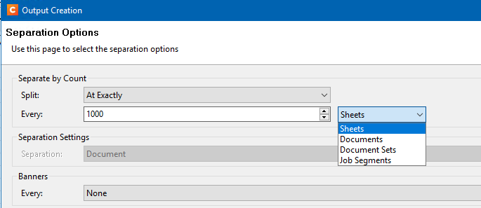

You need to look more closely at Connect’s Job Preset and Output Preset. You can group Documents into Document Sets in the Job Preset, sort them, and in the Ouput Preset you can “Separate” your output by Document Sets.
You can also Separate by number of documents, within the Output Preset, which seems to be what you’re looking to do:
