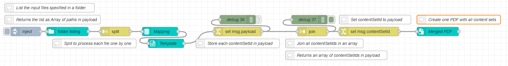

Hi @pascualj, if you are receiving multiple files and processing them in same time, I suggest using the Folder Listing node to capture the files from your folder and then process each file through DataMapper and Template. You can store the generated contentSetId for each processed file in the payload for example.
Once all listed files have been processed, you can join all the generated contentSetIds into an array and store it in the contentSetId property. The paginated output requires a single contentSetId or an array of contentsetId passed through contentSetId property.
Your flow could start with inject node, which you can schedule based on when the files are recieved. for example, once per day, or at a specific time interval, etc.
Based on your example, I understand that you want to generate a PDF without any additional processing, such as sorting, or grouping. Therefore, you don’t need to use a Job Preset in this case, as the Paginated Ouptut in OL Connect Automate can use either a JobSetId, if available, or a contentSetId as its input. In this case, you can use the contentSetIds generated from the Paginated Content directly and generate a single PDF.
The flow should look like the image below. I added comments to the nodes to guide you through the flow.
