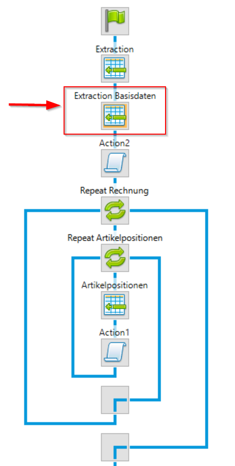

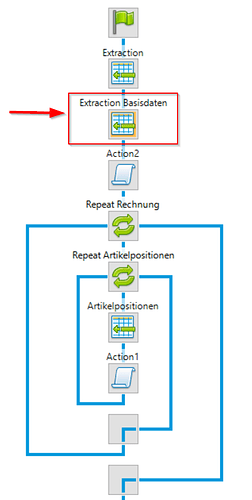

I now have an extraction step outside of the Rechnung-loop:

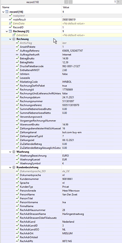

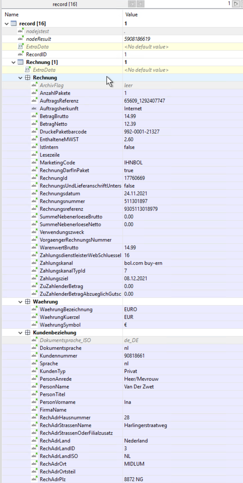

Yesterday after doing that the new fields appeared at the end of the field list in the datamodel. After loading the Datamapper configuration today, my fields are again inside the Rechnung table in the datamodel, and I again get the error message from the thread topic:
It is not possible to insert a text script for nested detail fields
Why does this happen? This is extremely frustrating, yesterday I thought I had a solution for this problem, and after loading the Datamapper today, the problem is back without any reason. It is not logical that the fields suddenly appear under the “Rechnung” table in the datamodel, since the extraction step is not inside the Rechnung loop.
I am also not able to just drag & drop the fields outside of the Rechnung table in the datamodel.
Why does the software act this way? Why are the fields outside of the loop in the extraction steps placed inside of the Rechnung table in the datamapper?

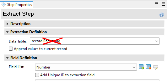

Have you checked the Extract step’s properties to make sure the name of the detail table is no longer specified?
Yes, I had, they were reverted back the next day.

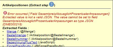

If I change an extracted field’s data type to JSON:
