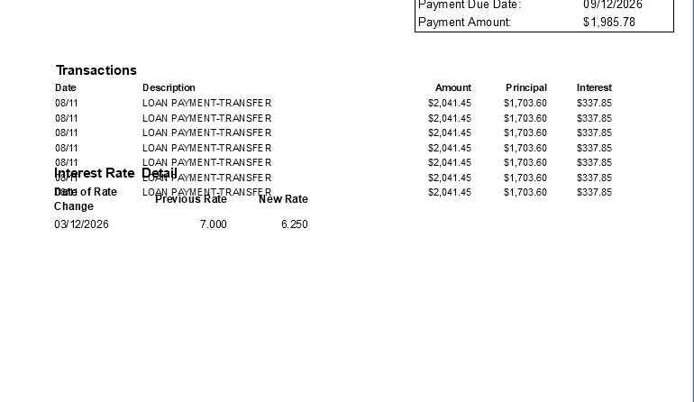

I would like the Interest Rate Detail table to snap to the bottom of the Transactions table, as there can be multiple transaction lines. The Transactions table is set to absolute position, because it will always start in the same place on the page. What positioning do I set the Interest Rate table for?
When I convert to inline, the table moves up to the top of the page. Which position is :inline anyway? Static? Fixed? None of the positioning options give me results I expect, and the poisitioning options in the table formatting box do not change the position no matter what I enter.

The Transaction table is out of the normal flow of the page as you removed it by making it absolute. Therefore, the Interest Rate table cannot be snapped (old PP7 terms :wink: ) to the bottom of it.
Assuming that the Transaction table is the first dynamic table of your page, what you should do is take all that there in fixed position on the page and put that on a Masterpage. Then set the Masterpage header and footer.
Then back on you section, put your Transaction table in a static or relative positionning and then add your Interest table.

I actually have 3-4 tables on page 1 of this statement. but most have only 2-3 rows. I positioned them all as absolute because they do not move, so everything on the page was “out of the flow” (a concept I am still struggling with). So when I changed the position attribute of the Interest Rate table, it moved all the way up to the top margin of the page, the first element in the flow. Everything was behaving as expected, I just didn’t know what to expect.
I changed all tables to inline (fixed or static?) and used margins to position them, which gave me the desired results. It is just a very different way of laying out a page than I am used to.

If the requirements are:
  1. Transactions table is absolute positioned
  2. Interest Rate table is directly below the Transactions table
.. I suggest that you introduce a container:
<div id="container">
    <table id="transactions"></table>
    <table id="interest-rate"></table>
</div>
Only the container would be absolute positioned.
The two tables should not have any explicit position style. This makes them both “part of the flow” within the container, with the Interest Rate table’s top edge flush against the Transaction table’s bottom edge. Moving the container automatically moves both tables.
The caveat is that you need to make sure the container (with both tables) fits on a single page, but I understand from your other posts that this is guaranteed.
