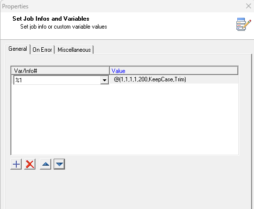

You may want to double-check how your data value is being assigned to %1 in the Set Job Infos and Variables task. If you are using the %c variable to read the contents of the file being received from your main process, then the plugin may include the line break characters into the value, which would make the URL invalid.
Try using a data selection instead, making sure to trim the results to also eliminate any extra blank characters:
