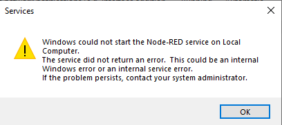

If I select Open Services and stop Node-Red, then restart I get this error:

Hi S,
Could you run the following test.
  1. Start CMD as administrator and navigate to the following directory:
C:\Program Files\Objectif Lune\OL Connect Automate\node-red
  1. Run:
node-red --settings "C:\ProgramData\Objectif Lune\OL Connect Automate\settings.js" --userDir "C:\ProgramData\Objectif Lune\OL Connect Automate"

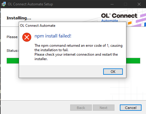

Hi Erik,
I did as you suggested. Uninstalled Automate, downloaded the 1.0.0 installer, default paths (as before) and get this error:
Not sure what to do about that :slight_smile:
Regards,
S
Could you try running the installer again? It looks like there was a Cloudflare outage earlier today.(fyi we are working on an offline installer which does not require an internet connection, no eta yet).
Thanks Erik, that was the issue. Installed successfully.
