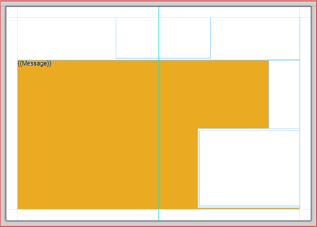

Here is the image the boxes are all inline and the message is my variable text that I don’t want to spill over to the next page.
I assume you want to run the text in the orange area, is that correct?
Yes I do without going to the next page I have it flowing around the boxes but when it is to long it goes to the second page.

To my knowledge, there is no way to achieve that exact design. I have run various tests, including with a newer OL Connect engine, and text will not flow around positioned or inline boxes when these are aligned to the bottom (the white inset in the lower right of the image).

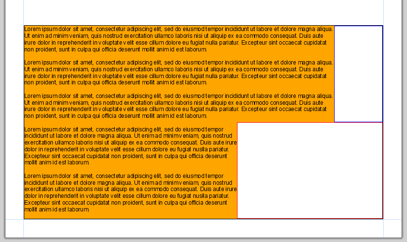

Perhaps I don’t fully understand what we are trying to achieve since Erik said this is not possible, but I gave it a try:
The text is restricted to the outer box so it will never flow to the next page. Copy Fit ensures that the text fits in preview mode. The inner boxes both have float: right which makes the text wrap around them. The bottom inner box also has clear: right to push it below the top inner box.
Some of the styles can be found in context_all_styles.css.

That worked perfect. Thank you very much. Can you tell me exactly how you made it? I tried but every time I did when I pressed space or enter to make a new line it dropped the inner boxes down.
Copying the HTML from my template to a different template is not sufficient, you also need the style rules I added to context_all_styles.css.
The float: right style is what makes the text wrap. If the inner boxes are pushed down after you press Enter in the outer box, I assume that means the inner boxes do not have float: right.
