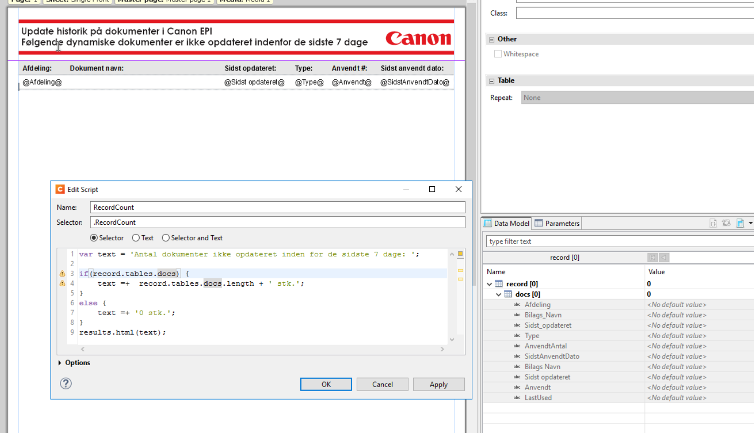

Hi
Have a datamapper just listing data from a csv file.
But when the csv file is empty, the template fails.
How do i make a check on if the table even exists ?
Tried this?
var text = 'Antal dokumenter ikke opdateret inden for de sidste 7 dage: ';
if(record.tables.docs) {
text =+ record.tables.docs.length + ’ stk.';
else {
text =+ ‘0 stk.’;
results.html(text);
To check wether a detail table exist and whether it is also not empty you can use the following:
if ("docs" in record.tables && record.tables.docs.length > 0) {
Thanks just what I was looking for.
